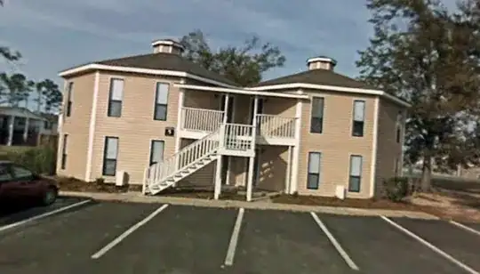

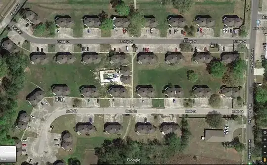

For reference, there are two-story hexagonal apartment buildings in Waveland, Mississippi that share a common wall and are divided into quadrants in the interior.
