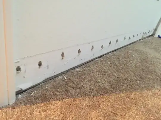

The suggestions from @sborsher, @Bryce, and @DMoore were fantastic, and gave me a lot to investigate (and budget) for. However, for my specific case, I had talked to over a dozen contractors. One - Sasha Grote - suggested a fantastically simple & effective solution that fit my budget, was minimally invasive, and even if it had failed, it would have provided a solid actionable data.
Solution
  1. Remove the baseboard along the squeaky wall
  2. Using an impact drill, insert 4 inch screws every 3 inches or so.
  3. If it works, DONE
  4. If it doesn't work, you know it's not the wall-anchoring-to-the-floorboard.
Success:
baseboard-4-inch-screws
