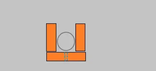

The punch suggested by SpectralGhost is a good idea.
If that doesn't work, you can make a jig with three pieces of 2x4.
pipe jig
Screw the pieces together and drill a pilot hole for the drill bit (the dotted line) using the same size bit you intend to use on the pipe.
