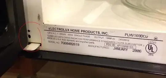

My microwave door slacks down and I have to lift it up a bit before shutting it. I sent this picture to Frigidaire and asked what I should do:
Their support emailed me back saying:
I'm sorry, there is no screw that goes in the hole. that actually is a broken spot weld for the hinge. The hinge cannot be repaired.
Here's a short video of the issue:
http://www.youtube.com/watch?v=mMWu6HFAwN0&feature=youtu.be
I want to fix the issue without replacing my entire microwave. Anyone have any ideas on how I can fix this?

I had the same problem. I fixed it with a small screw, washer, and nut. On my Frigidaire microwave, the hole does go through both the door frame and the hinge piece. I had to pick a screw with a shallow head.
Now, several years later, the metal at that point is beginning to crack, and the door is sagging again. I am not sure what to do, but I did lengthen the life of the microwave.

It's hard to tell from your video how the hinge works. It probably works like the top hinge. If it is simply attached to the front like the "broken weld" suggests, then your goal would be to reattach it. My go-to for this would be a steel rivet. If you don't have a handheld riveter, I highly recommend getting one. They come in handy. Though, if there is no existing hole in the hinge part, it might be impractical to make a hole to accommodate the rivet while the microwave is assembled. Bare in mind that disassembling the microwave would make some on this site uneasy. I say use your common sense. If you feel uncomfortable or that you're not up to it, don't do it.

I just fixed the same problem. 6-32 screw from the outside and a nut on the inside. I was unable to get it off the wall so I just removed the screws that hold the bottom on and fixed it from underneath.
James
I did the same as James without having seen this thread. The screw used must be a flathead type so that it does not protrude from the front of the microwave chassis and interfere with door closure.
