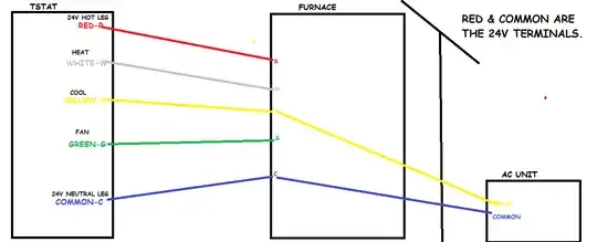

The YELLOW or Y terminal at the furncae/ air handler is a dummy terminal for convenience, it is not required to be used, you could send Yellow directly to the AC unit out doors. Common will be used since the Common leg of power comes from the transformer which is in the furnace. The Yellow going to common likely if you trace it back it in fact is Common leg of the 24 v power supply.

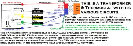

enter image description here[![Below is a typical residential thermostat,it's terminals & their circuits.
Red - the 24 volt hot leg enters the thermostat White - is the Heat circuit. Yellow - is the Cool circuit. Green - is the fan circuit Common - is the neutral leg of the 24 volt power supplied by the transformer and the side of 24 volt power that every 24 volt circuit terminates to complete the circuit.
Between the Yellow,Cool & Green, Fan circuits inside the thermostat is a switch that closes connecting Yellow to Green if the thermostat is set in the Auto position. In the Auto position the fan circuit is energized when the Cool mode is energized. The fan in Heat mode is controlled by a temperature delay located in the furnace.
The transformer reduces 120 volts to 24 volts,a safe voltage. The 24 volt supply like every electric circuit has a "hot leg" and a "neutral" leg or "side" of power,like a car battery has a Positive and a Negative terminal,The neutral leg of 24 volt power is named"Common" because all 24 vol
The "hot leg" of 24 volt power supply is Red, it enters the thermostat on the Red terminal. The thermostat distributes the 24 volt hot leg to the desired circuit. Upon a call for heat the switch between Red and White will close sending 24 volts to the gas valve, from the gas valve it returns to Common to complete the circuit. Upon a call for Cool the switch between Red and Yellow closes. Upon a call for Fan the switch between Red and Green closes]2]2
