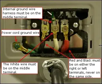

Here is a good image of a 4-wire cord connected to a dryer. enter image description here
If you are going the other way, from a 4-wire to a 3-wire, then you MUST connect the internal green wire from the harness back to the chassis screw.
