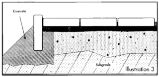

You can lay a soldier course of the pavers to edge the patio, and then lay a wedge of concrete to lock the soldier course in place. You can cover over the concrete with dirt after it cures.
