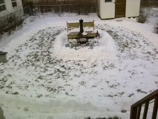

Here is a photo of my yard and the approximate dimensions I'm going for (built with tentative snow walls). I'm going for a skating oval, with a larger piece in front and the fire pit and bench in the middle.
back yard ice rink

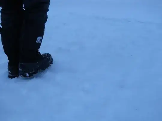

First, wait until you have good snow cover and you're confident it isn't going to melt away on a warm day. For us, Boxing Day (Dec 26th for those in the States) is the traditional rink-starting day. If the snow is "packing snow" we can stomp as is; if not we put a spray attachment on the hose and spray water on it as we go. Working in squares about 8 feet on a side, and wearing thick heavy boots (visitors in delightful city boots with narrow pointy heels don't get to help, or get to borrow boots) we just stomp down the damp snow into almost-ice, walking over the same sections again and again to eliminate the holes and ridges from the time before.

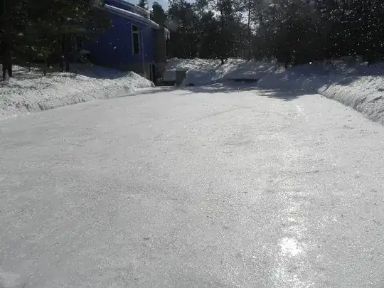

our rink in January
We lift the shovel carefully as we clear snow to make the edges, and we water those too which hardens them enough to mostly keep pucks out. We have over a hundred pucks (gathered by a bored younger brother hanging at the arena during years of skating lessons) so if a few go into the snow we don't worry, we can gather them in the spring. You can also water the hillside if you have older children who can handle it. The non-flatness of the lawn is a feature - beginners can be put at the top of a slight slope to give them a boost, and coming up that slight slope slows you a little before you need to turn.
It's less work than you think, and incredibly rewarding. Ours is at the bottom of a hill so it also adds fun to tobogganing, but the real point is that anyone can skate any time, for 10 or 15 min if that's all they want, or all evening, and you can have skating parties. It doesn't really take any skill or equipment other than the hose and a snow shovel.
