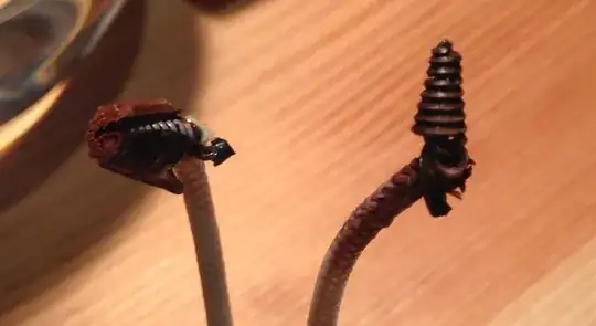

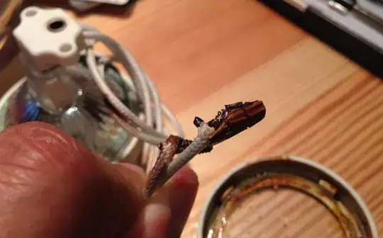

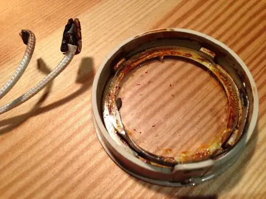

I took a closer look and I saw that the connections between the incoming 12v wires and the short wires going to the socket were in bad shape. Those connections were apparently made using wire nuts, and the plastic from the nuts had melted away completely. On one lamp, there was no plastic left at all, the naked wires enclosed by the wire nuts' metal spirals were sticking out. On the other lamp, one wire looked the same, and on the other one half a plastic cover was left. See the photos.

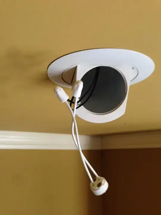

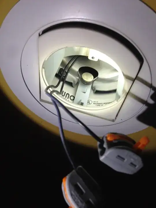

What's the proper, heat-safe way to connect the wires in this case? There's not much room in there, see the fourth photo below. I usually use WAGO lever connectors instead of wire nuts when I connect something and I was going to do the same here when I re-do the connections, but I'm not sure they'll perform any better in heat.

I read somewhere that halogen lights reach temperatures above 300°C, so the plastic high temperature wire nuts mentioned above are not an option as they are only rated up to 150°C. The WAGO nuts I intended to use were also not appropriate as they are only rated up to 105°C.
