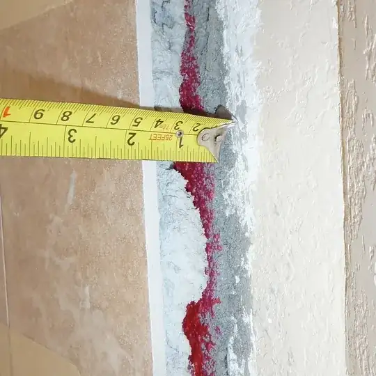

We hired a contractor to remodel our master bathroom. For the tile installation in the shower, he started with a float-cement backing. To show quick progress, he rushed through this step and the final surface was uneven with deviations of over an inch in some places. He assured me that this was no problem and proceeded with setting the tile. To make it come out straight, he had to use well over 1 inch of thin-set in some spots:
Thin-set thickness
After pointing out to him that the instructions for the thin-set he used (MultiSet Modified Thin-Set Mortar by Custom Building Products) state that it should not be applied thicker than 1/4", he told me that he had mixed in some Portland Cement (Spec-Mix Type-S) to give it extra strength and that I shouldn't worry about it.

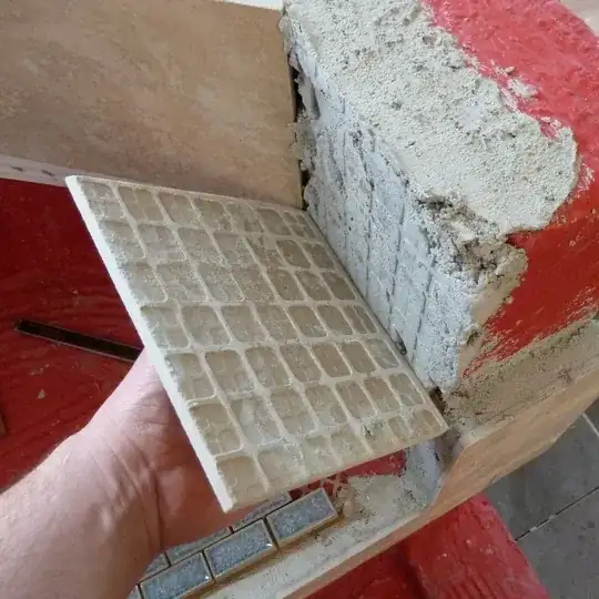

He had to pause installation for a bit and after 12 days of curing-time, I tried to see if I could peel off one of the tiles (a 7 1/4" x 7 1/4" piece that was crooked and needed to be redone anyways) by hand and it popped right off in one piece:
Peeled off tile

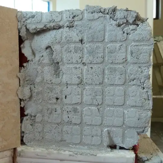

And left the wall underneath it looking like this:
Thin-set
Is this how it's supposed to be or did the added Portland Cement reduce the thin-set's stickiness? Are there any other potential issues with mixing cement into thin-set and applying it in this thickness?

Portland Cement has poor adhesive qualities by itself, which is why it is commonly mixed with a polymer. By definition, "thin-set" refers to an application thickness of under 3/16th of an inch. Other common additives to thin-sets are water retaining compounds that help them retain moisture to extend the curing time for more strength. By adding additional Portland Cement, both of these properties have been compromised in the mix. As far as curing goes, the ANSI spec for thin-set performance specifies a final set time of under 4 hours (this link has a good run-down). Tiles should be difficult to peel off within an hour.
That said, there are several other issues I can pick out from your pictures:
  • Even if the tile does adhere properly, the grout will most likely start cracking within the first couple of months. There shouldn't be any of the huge voids visible in the bottom two pictures, especially in the corners. When you float grout in, there won't be anything to support it in places other than the sides of the tiles themselves and any minimal keying from packing it into the joints.

I think @DMoore hit the nail on the head with this one. You need to have this contractor stop work immediately. The simple fact that he can't lay tile straight (and isn't using spacers) is fire-able in my book sub-strait aside - now you're talking about what you will see when it's done. Schedule a time for a building inspector to come by and take a look at it (you did get a permit, right?) - they are generally less busy this time of the year, so will be a lot more willing to give you a good opinion. Tell them that you are concerned that the work being performed isn't up to code and that you'd like somebody to take a look before it gets covered up.

Whatever he did to modify the thinset obviously does not work to the most extreme power - so it doesn't matter. Obviously he added something to the thinset or your tiles would stick much better. If it was a pure "thinset fail" then it would be pulling from concrete. There is no use arguing with the guy. It didn't work. Get your money back. Don't let him touch your house again. Sorry.
