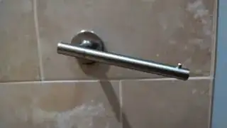

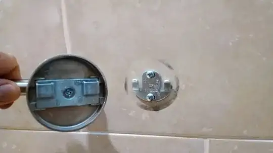

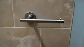

I have a toilet paper holder attached to a tile wall with a single finger bracket (per the manufacturer). The holder constantly slips the finger bracket, goes loose, and leans to the side. The finger bracket is quite secure to the wall and does not budge.
How can I secure it?
I'd rather not have to unscrew the bracket from the wall to repair this.
I would prefer to avoid having to mount it "permanently" via epoxy.
unslipped to scale slipped to scale interior

If it is the finger bracket on the wall that comes loose then you'll have to investigate how it is currently mounted. If the two screws there are already go directly into a stud or wooden cross member then some longer screws may be in order. If the screws just go into some cheap plastic hollow wall anchors then you may want to investigate some more secure types of metal anchors such as toggle bolts or molly screws.

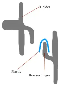

It might be possible to bend the fingers of the bracket on the wall inward a bit so that it pulls the holder more snug to the wall giving it enough traction to hold more firmly without being permanently glued in place. Try tapping the fingers lightly with a hammer (test fitting often) until they are bent closer to the wall enough. Otherwise you could unscrew the bracket and bend the fingers with pliers, but it may take a few tries before the desired fit is achieved.
Another possibility may be make the fingers of the wall bracket fit more tightly by covering them with a small strip of plastic, perhaps like that from some blister packaging; some heavy paper might work alternatively.
