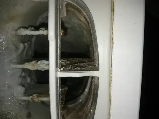

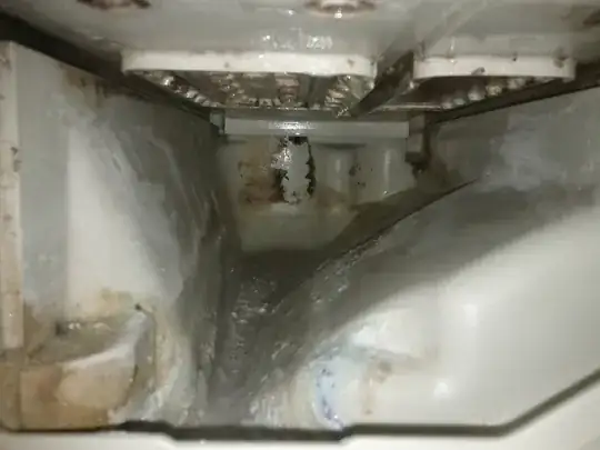

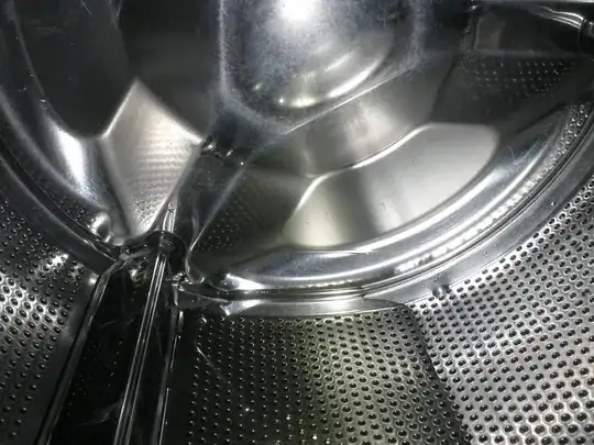

Here is a pic of the inside of the Dispenser Drawer (with the Drawer removed), of the big tube going down from it, and of the drum:
Dispenser Drawer:

Big Tube Going Down:

Drum:

(The liquid you see in the Drum is bleach that I added there directly for another Hot Cycle wash I'm currently doing.)
Based on those pics, the inside of this machine is completely nasty despite the outside of the machine and drum looking perfectly fine and the machine itself working fine.
Is this fixable or is this machine doomed? If it's the former, then how can I fix this?

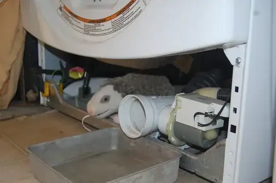

Here's what I do for this exact problem, on a similar model from a different vendor:
Whirlpool Duet Mold Solution
The clamp in the back is to bypass the safety switch. We drain the residual water out of the washer by removing the large object filter, after every load. Yours probably retains a similar amount of water. Then we leave the door open between loads, and sometimes run a fan, even though this is a real pain. Note the wires of a water alarm just visible under the stuffed animal: we've forgotten to replace the filter more than once.
Forget about cleaning the inside of the drum mechanically: I watched that process once. The guy knew exactly what to do, and it took most of a day, with part of it requiring a helper. We lucked out as that was a flat rate repair.
A bleach load never really helped. A citrus based washer cleaner (not the brand made by Whirlpool) worked better. But ultimately only drying the unit out between loads really was effective.

Now as to your specific machine @ProgrammerGirl , you're using too much soap. Note the soap scum everywhere in the pictures. Pick up a bottle of citrus cleaner, run a super hot load, and then lay off the suds.
