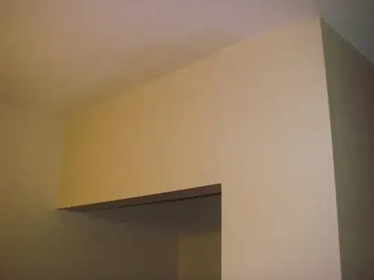

I had basically the same situation in my 70's-built house, the closet doors went all the way to the roof, and were horrible looking bi-folds.
before

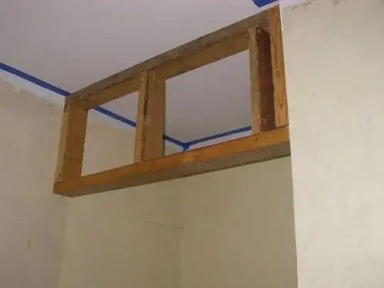

Basically what I did is framed in a header to bring the opening to 81" (remember to account for 1/2" drywall while framing):
new framing
Then some drywall and paint (note I didn't yet repaint the ceiling in this picture):
drywall complete

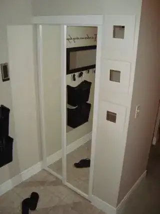

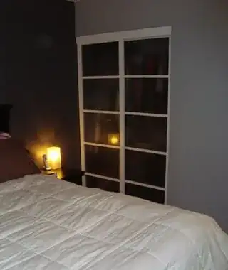

I had 4 closets like this. One by the front door got sliding mirror doors, the rest got frosted-glass sliding doors. The right picture below is actually the "after" shot of the first one in this answer.
finished with mirror doors finished with frosted glass doors

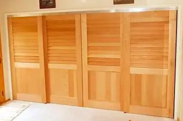

A quick search turns up some custom closet door manufacturers, which might be an option to get multi-panel sliding doors, like this:
alt text
If you do this you can probably also get them 8' high, but honestly, even without the doors on, just making the opening 81" really updated the look of the house.

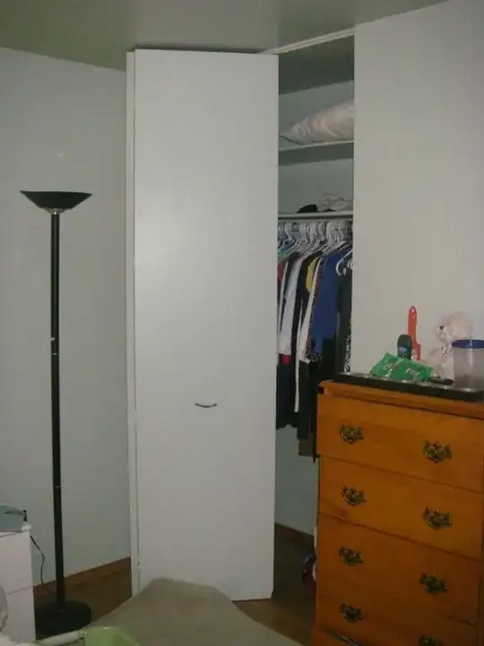

One option might be to get a set of bi-fold doors. Hanging one on each side of the opening would mean you will lose a few inches on each side when the doors are open, but the distance that they would cut into a room would be much less than the full door. With an 81 inch opening you should be able to lose a few inches and the opening would still be big enough for two people. Bi-folds are cheap, come in a variety of sizes and designs and are pretty easy to install.
Before doing any of this however two tips: first, check the opening to see if it's square and level. If it is then the job should be pretty straightforward and easy, if not it's still doable, just a little harder. Second, empty the closet before you start.
