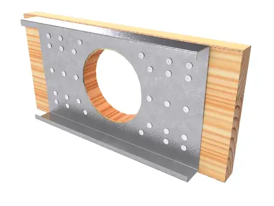

enter image description hereThis bracket provides a building code approved solution for holes up to 6" through as many joists as you want - Joist Hole Reinforcer. Full disclosure, this is a product that I sell for the exact application in question. There are other ways to reinforce joists with holes, but I believe this is the only one that is code compliant out of the box. Hope this is is useful and helpful to others, not intending to spam.

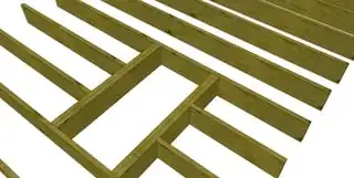

Adjusted Framing
If it was only a joist or two, boxing off the section might work. Using this approach for 5 joists, may or may not be the best way to go.

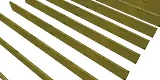

Joists before
Joists after

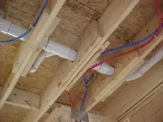

Engineered Plans
Another option, is to consult an Engineer. The Engineer will be able to provide a solution, and will include all the documentation required for the solution to pass inspection.
Engineer approved solution
NOTE: While the above image was a solution designed by an engineer, it is not a solution that will work in all situations. This solution will not pass inspection without the proper documentation.
