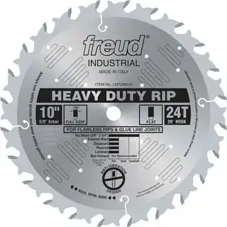

Flat Top (FT)
As the name describes, the tips of these teeth are flat, or straight across. These blades produce the courses cut, and often result in lots of chip out.
FT Blade

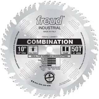

Combination (COMB)
These blades consist of groups of teeth, where one will be FT with the rest being ATB. Typically there will be a group or 5 teeth (1 FT, 4 ATB), where each group is separated gap (gullet). These are more general use blades, and do fairly well at both ripping (cutting along the grain) and crosscutting (cutting across the grain).
COMB Blade

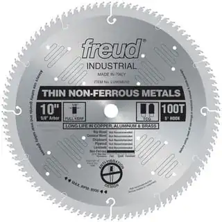

Triple Chip Grind (TCG)
The teeth of these blades alternate between a FT tooth, and a double beveled tooth (bevel on left and right, with a flat top). They are good for cutting hard materials, so are often used to cut MDF, plastics, and laminates.
TCG Blade

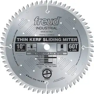

High Alternate Top Bevel (HiATB)
These blades have alternating beveled teeth like an ATB blade, except that the bevel angle is much greater. An ATB tooth is typically beveled at 10-20°, a HiATB tooth will be beveled at 25-40°. These blades are good for extra fine crosscutting, and reduce chip out to a minimum.
HiATB
freud blades used for example purposes only, because they show the tooth configuration on the blade. I have no affinity towards freud.
