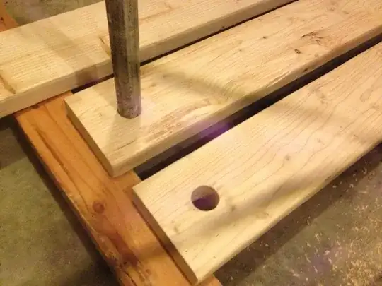

I'm making a stand-alone pullup bar and I bored 1 1/4" holes in 2x6's for my 1" galvanized pipe (1 1'4" outside) to slide through. Only the pipe is definitely 1 5/16" (thank you, guy at Lowes) and I can barely thread the first 1/2" of it with all my strength. I tried wrapping lots of sandpaper around my speedbore bit with a dash of 3M 77 and that slightly worked but the sandpaper wore out way too quickly to ever get me there.
Does anyone know how to uniformly sand the inside of the holes to give me my 1/16" of an inch?? I've only been able to find videos on how to go from one size bit to another, but nothing on how to make the hole you already have slightly larger.

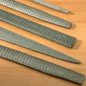

You might use a half-round rasp or file.

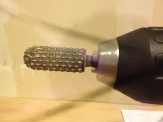

Thank you to everyone for your insight! I made a quick stop at the Lowes down the street and picked up a few inexpensive options you all mentioned. The one that absolutely stood out for my purposes was the drill rasp. As soon as I began I knew it was the one.
I went back over 4 holes, each taking about 1-2 minutes to effectively widen and shape. I was very happy with my level of control.

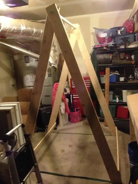

Here's the finished pull-up bar. I had to build it in some tight quarters due to some choice weather. It can be used then collapsed and slid in a tight spot. Again, thank you all for your wonderful help. This new guy got way more feedback than he was expecting! Cheers

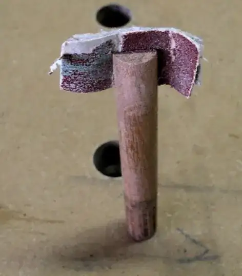

I think your best bet is to use a sanding process to open up the hole. It may take a while but should get you there eventually. When I had a similar problem I took a piece of 1/2 inch diameter birch dowel rod (about nine inches long) and cut a slot across its end. Then inserted a folded over piece of sand paper to make a two sided flap sander. Chucked into an electric drill one is able to sand the inside of the hole with ease.
Flip over the sandpaper in the slot to utilize the back side of each flap or just reverse the drill rotation direction.
You'll have to experiment a little to get the optimum size for the sandpaper piece. Its actually twice the size needed and then folded over paper side to paper side before being slid into the slot of the dowel.
Replace the paper as often as needed.
Here is a picture from on-line to give an idea of what it would look like. Sometimes using a cloth backed sandpaper can last a bit longer with this technique if you have that available.
In your case I would make the slot in the dowel about 1.25 inches deep and slide the sanding piece all the way into the slot instead of hanging half way out as showing in this picture.

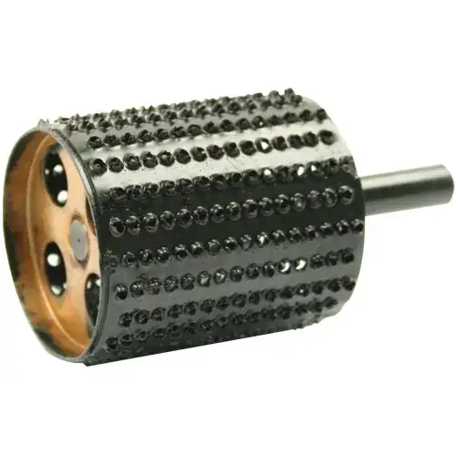

There also exists a tool like this called a drum rasp. It might help your situation.

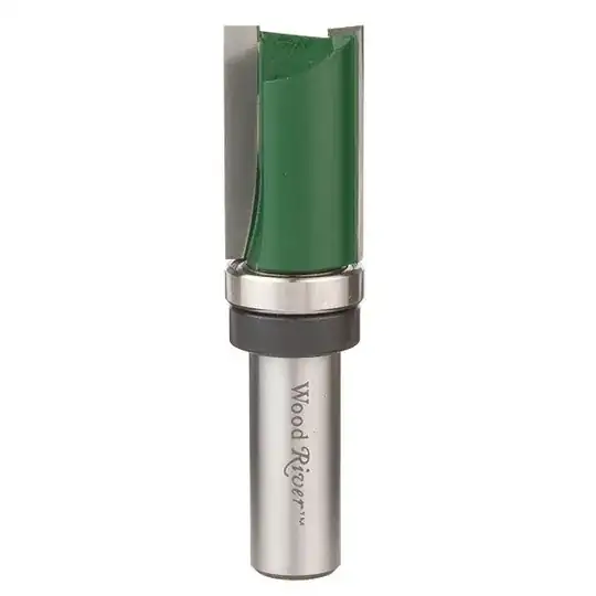

Enlarge by cutter If you REALLY want to make this PERFECT, you can use a router. Take it off once side with a 3/8 guide bushing and a 1/2" bit, then put on a 1/2" bushing and do the other side.
You could even use a tracing router bit. They have bearings and blade that'a almost identical in diameter, except the blade almost is always JUST wider than the bearing. It'll take off about 1/128th of an inch at a time, so you'll have to trace around your hole about 20 times to take off such a small bit of material.
