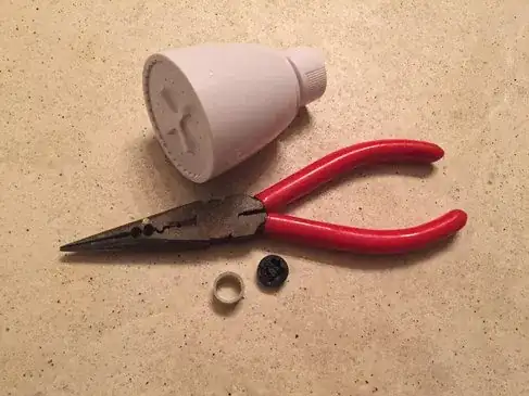

Remove flow-rate restrictors in the shower head
You can make sure that there are no water flow rate restrictors inside the shower head. These can usually be pried out (I've done this on hand-held shower heads, too; see also this video):
taking out flow rate restrictors with needle-nose pliers
Or you might need to drill a bigger hole in the water inlet of the shower head (which I've done on larger shower heads).

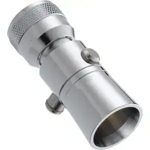

Every Lowe's or Home Depot and other places like that have a shower head that looks something like this and I find I get a much more satisfactory result when I have low water pressure. It's just got a concentrated, small diameter of holes, and solid brass insides. They tend to run anywhere from 4-12 bucks depending on where you go and what brand is available in that store at that moment. Anyway, while they don't increase the flow, and they don't increase the pressure, they seem to at least concentrate the flow and improve the experience, and you don't need to alter them.
shower head
