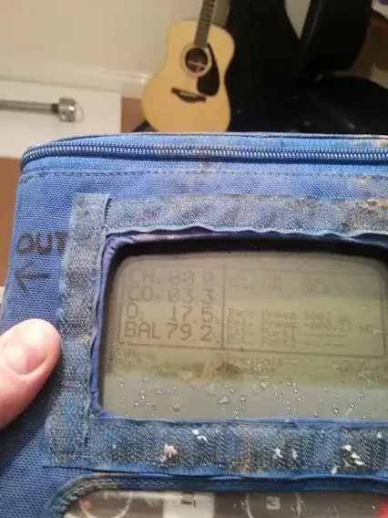

An insepector from the local council has installed a data-logger, whilst he was in the basement he took a reading that I've attached below. When this reading was taken the air felt poor, but by no means the worst it's been, a candle wouldn't stay alight. An breathing during conversation seemed laboured. It looks like the assumption of displacement doesn't look correct, there's more to it. Here's the readings:
Gas - Reading (Normal)
CO2 3.3% (0.04%)
O2 17.5% (20.8%)
Other 79.2% (unchanged?)
