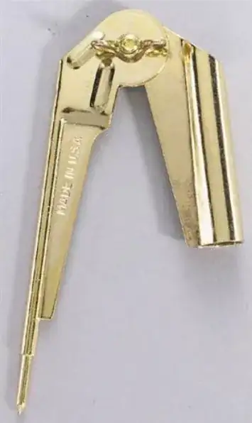

For the scribing operation you want to either use a scribing tool (see picture below) or find a small piece of material that has a thickness approximately equal to the largest gap between the floor and the bottom of the bookcase. Let's say the largest gap is 1/2 inch. You would use an item that is 1/2 inch thick (or set a scribing tool to 1/2 inch). Now slide the small piece of material along all the lower edges of the bookcase as it sits on the floor. In each position draw a line onto the sides and front kick pieces of the shelves. (The scribing tool would have its straight arm drug along the floor surface while the pencil draws a long onto the shelf side).
The next part of this scheme is to saw along these scribe lines and cut away a small part of the sides and kick boards. If done correctly the two shelves will now perfectly match to the floor at their intended position and be nice and vertical and straight.
Here is the picture of a scribing tool. Get these at most hardware stores or home centers that sell tools. A standard short pencil fits into the one side of the tool. Set the point of the pencil to be approximately even with the point on the other arm of the compass/scriber tool.

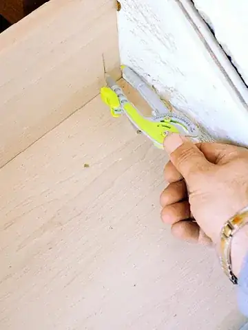

There are two ways you could do this, both start with shimming the bookcases so that the doors operate the way they should. The shelves do not need to be perfectly level and plumb, they only need to look that way so they do not draw attention from being out of level or plumb.
After the shims are set the way the shelves or better to say, doors work the best, measure the gap at the floor at the widest dimension there is. If you have a compass scribe, you set the scribe to the widest part of the gap, mark it, and cut the bottom to conform to the floor. You could use a pencil with a gauge block of the right thickness to do the same. Maybe even pinch the pencil between your fingers to keep it a consistent height as you mark the bottom will work too.compass scribe pencil scribe
