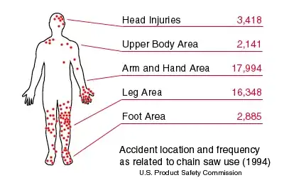

A diagram put out by the US Product Safety Comission shows that the left leg and left arm/hand are the most commonly parts of the body injured by chainsaws:
(Source: OSHA Web site)
If the dots on the diagram represent frequency of injury, protecting the left hand would help prevent a common source of injury.
The State Compensation Insurance Fund website also states that "The most frequent chainsaw injuries occur to the left leg and the back of the left hand."
The diagram on the OSHA site dates back to 1994, so it's not clear if modern safety features like chain brakes have changed the distribution of injuries.
Note that the STIHL Cut-Retardant Gloves referenced by the asker of this question only provide cut protective material on the left glove: "Engtex®, a cut-retardant material, is sewn into the back of the left glove", so Stihl too has identified this as a particularly vulnerable part of the body.
To be honest, from personal experience, I'm unsure why the back of the left hand is so frequently injured, it must be because that hand can slip off the grab-bar when the chainsaw kicks back and the hand slides into the moving chain.
