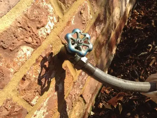

I am trying to connect a garden hose with the faucet. After connecting and turning on the faucet, the water still squirted out. Please see the attached picture.
I am not sure whether I need a wrench to tighten it, or it is just because the faucet or hose connector are too old. Or in other words, is using a wrench to tighten a hose connector a required procedure?

It's possible to get the hose screwed on by hand tightly enough that it won't leak if your grip is strong enough; I think the strength required is within the normal range for an adult (mine is relatively strong though, so your mileage may vary). But before you get a wrench, there's a couple of things you should check:
  • make sure the threads on the faucet and on the hose are clean; if they've been disconnected over the winter, they could have picked up some dirt or grit which is preventing you from getting a good seal.
  • the hose is supposed to have a rubber washer to make the seal against the end of the faucet. If it's missing, perished, or not seated correctly, then you won't get a good seal. You can get packs of washers (more than you'll ever use, probably) cheaply at the big box stores.
Once you've got those taken care of, try it with the hose screwed on hand-tight. If you're still getting leaks, you can try using a wrench, but remember that tightening is good, over-tightening is bad because you start to deform the rubber washer, which reduces its effectiveness. Get the hose hand-tight, then use the wrench to go another quarter-turn or so. If it's still leaking, it may be time to get a new hose.

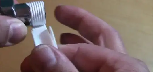

If the leak is around the threads themselves (you can tell vs gasket based on where water comes out), teflon tape (sometimes called plumber's tape) exists for this. It's readily available at hardware and home improvement stores, and very inexpensive.
Just wrap it around the faucet threads a few time and screw the hose on and it will make a good seal. It's not permanent, you can remove / replace it after removing the hose.
(Image source: http://plumbing-n-electric.wonderhowto.com/how-to/use-ptfe-tape-teflon-tape-threads-294854/)
Generally I use teflon tape on all summer / long-term garden hose connections by default, leak or not. Combined with garden hose gasket, you don't even need to tighten the connection that hard.
