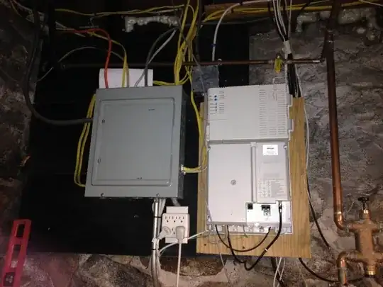

I'm thinking about installing a new circuit. The panel is on the wall in an unfinished basement. Three questions:
  1. Is the new NM cable going down to and around the panel considered to be "subject to physical damage" (300.4) so it must be protected as described in 334.15(B)?
  2. Does the matter whether the cables are above, below, or on the side of the panel, or how high up it is?
  3. If protection is required, should I sleeve them in EMT up to the floor joist cavity? Are there other solutions that are practical?
I'm in Massachusetts, so NEC 2014 applies with these amendments. After much digging, I haven't found anything explicit in the code. But I'd like to know not only what the NEC will let me get away with, but also what is sensible and good workmanship. I wish I could look at what's already there for guidance, but it looks like this … at least I would like the new work to be done properly.
panel
I'm unsure about how to interpret the following from 334.15(C):
Nonmetallic-sheathed cable installed on the wall of an unfinished basement shall be permitted to be installed in a listed conduit or tubing or shall be protected in accordance with 300.4. Conduit or tubing shall be provided with a suitable insulating bushing or adapter at the point the cable enters the raceway.
Does this mean that if you have NM on the wall in an unfinished basement, then it is considered to be subject to physical damage, and you must put it in listed conduit or tubing unless it is already protected as described in 300.4 (none of which seem relevant, especially since the Massachusetts amendments delete 300.4(D))? Or can it still be unprotected if it is somewhere that is not subject to physical damage (however that is decided)?

It's definitely a interpretation issue with the local inspectors. You can improve the installation in the picture by following the guidelines in 110.26 they may allow the wire within the working space about the panel to be not subject to damage but the water line should be rerouted to be outside the working space described in 110.26 also the wire should be supported per 334.30.

What I would do, and I’m not kidding, I would find a large, nearby housing development, where they are currently building homes and pretend I’m interested in buying and have look at some samples. Hopefully the electrical services are in the basements and they’re unfinished. Study how the wires are installed for everything down there sump pump receptacles, HVAC equipment, everything and then you’ll know. What you’ll most likely be looking at is a no frills installation, just enough to be approved, no less and no more.
