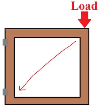

I'm building a wooden gate for my deck, and I want to put in a cross brace to reduce sagging. I want to install the brace so that it transfers the load from the top unhinged corner, to the bottom hinged corner.
I'm just not sure what the best way to achieve that would be.
Given the image above. How should the cross brace be installed? Does it even make a difference?

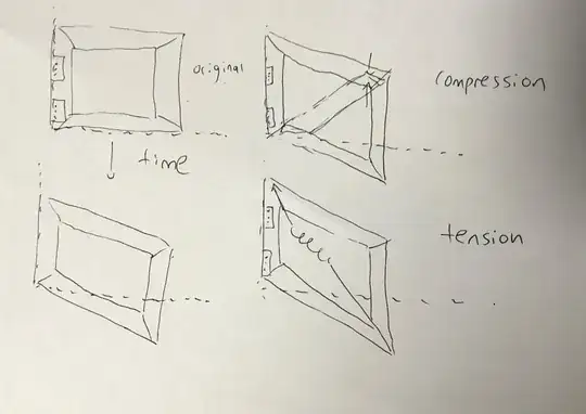

See poorly constructed diagram below:
gate sag

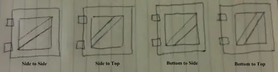

  1. the direction of your cross brace is wrong. It should go instead from top left to bottom right.
    The reason for part 1) Try and imagine that the load you have drawn will push down all the way to the bottom right corner. This is the part that will move most if not secured. This gives a key to which part you need to secure most.
  2. All the drawings you have drawn are quite similar. They all have material going directly from corner to corner "through" the cross brace.
  3. None of your drawings have the theoretical ideal. This involves an element going directly from corner point to corner point. However, because this is a small force over a small distance it really doesn't matter if you attach the cross brace in any of the ways you have shown. Indeed,you should do so, because it makes the fitting much easier for you. This way of attaching elements, not exactly to the corners, but offset, is/was commonly used in steel bridge construction among other things. It exposes the crossbracing element to some bending forces, but this is not really of any consequence here.
  4. Almost any material and thickness that you use will be strong enough, unless you are insane and go for string. (which would work as long as there was no upward force applied!!) Simply choose something strong enoough not to break if it is hit side on by someones foot or some other accident. And secure it cleanly to avoid rotting, etc.
hope that helps

The answer is #2
If you eliminate the outside vertical and the bottom horizontal... Which of those designs would still stand on their own? :)
