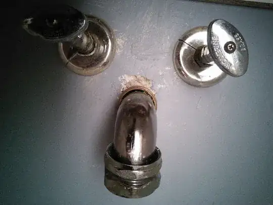

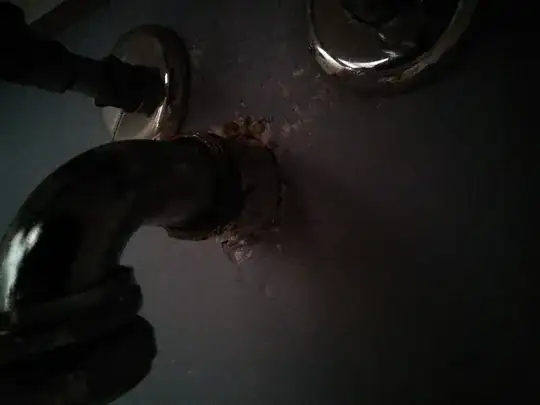

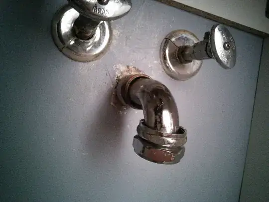

I was replacing the sink this afternoon when I noticed that the p-trap would not reach the drain pipe. No biggie, right? I'll just buy some extensions from the local big box and be on my way.
I attempt to take off the drain pipe so I can fit an extension on and what I can see appears to be someone who took a 1.25" pipe, shoved it into the 1.5" hole (with the threads "holding it in") and then tightening everything up.
Now, I'm trying to unscrew this mess (literally) and I can't get the pipe out of the 1.5" drain. I'm wondering if I should try to heat up the system with an acetylene torch to try to make everything a bit more pliable or if I've got no other choice than to get a plumber to come and rerun the drain in the back of the wall.
The input of this community would be most appreciated.
Here are some photos:

I'd slip a cheater bar into the drain and see if you can pop it loose by turning it clockwise (so you don't unscrew the tail-piece). If you can get it to turn without twisting it you should be able to get it to pull out. If you can't and it starts to twist the pipe without breaking it loose, cut it off with a hacksaw close to the tail-piece leaving enough of outside to grab with a pair of vise-grips. Then take a hacksaw blade and carefully cut through the pipe from the inside. You should then be able to use a vise-grip or pliers roll it in to a smaller diameter and pull out the last bit.
Comintern
  • 6,965
Do not use an acetylene torch! That will melt the pipe and make holes, cracks, etc. in it.
I suggest turning with great force. A 18+ inch pipe wrench applied to the insert will probably unscrew it so it will just slide out.
Otherwise, it will turn the outer pipe loose from whatever it is connected to. If the outer pipe was built well, it is fastened to structural framing which will easily hold it in place. Just unscrew the whole assembly and either replace the 1.5 inch pipe or separate the two and replace the 1.5 inch.
If that is a standard wall, there is an elbow just a few inches inside the wall, so it will be quite easy to re-install.
wallyk
  • 12,399
Dissimilar metals, the inside of the iron pipe will have rusted so tight to the brass pipe that you will need a half-round cape chisel and patience to get it out.
This is a normal installation, the 1 1/4" pipe is supposed to slip in rather loosely into the larger pipe with a threaded ring and rubber gasket to make it water tight. Years of corrosion have won out.
Been there on this one; if the recommendations already made by wallyk and Comintern don't work, chiseling it out is all that's left.
It would help to know what's inside the wall as in, does the iron pipe thread into an iron Tee with the rest of the system being iron till it gets to the larger diameter pipe? Most of the Swede bar methods mentioned will need to take that into consideration otherwise dealing with the aftermath can be kind of annoying.
BTW, I have seen 1/2 iron pipe rust internally till the water channel was less than the diameter of a pencil, quite something to see.
