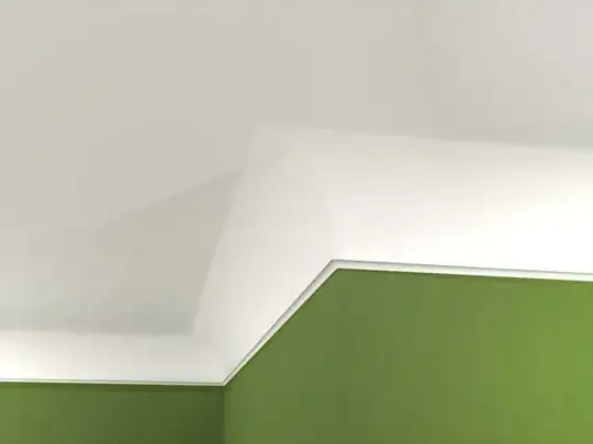

We are moving to an apartment built in the 1920:s which have a fillet between the walls and the ceiling. We want to paint the walls, and to get a nice finish between the ceiling and the walls, we want to paint a distinct line around 10 cm down from the ceiling. See attached image.
What would be a good way to make a straight line, when the walls and/or ceiling is not perfectly straight? I'm thinking perhaps you could make a jig which fits in the fillet?

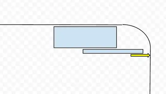

As far as positioning a line that goes with the flow of the ceiling, I would make a jig by screwing a few blocks of wood together that holds a pencil. Use it to mark the wall and you'll have a visual guide to follow when you freehand. The yellow arrow in the sketch below represents the pencil and I would use a big enough block that averages out maybe a square foot or so of ceiling. if you see sections of the line you don't like (because the jig hit a bump or whatever), just erase the offending section and use a long straight-edge like a 4-ft level or strip of trim to redraw the line.
Edit: If your ceiling is very uneven, attach three (not four) "feet" to the top of your jig. Doesn't really matter where, just position them away from each other in a triangle. This will prevent the jig from rocking on the high spots.

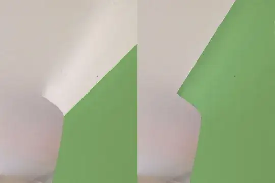

One thing I read awhile ago and have applied with good results may be applicable here. This answer is more about where you put the line instead of how to get it straight. For getting it straight you may be able to just eyeball it and where you put the line may make it more noticeable. Maybe even use a combination square to make sure the tape is square to other tape that runs perpendicular to it. Looks like an older home and floors and walls my not be square but if you have the paint lines square to themselves I think it will look good.
What I read is you paint the ceiling first, then when you tape the ceiling to paint the walls you leave about a 1/8" gap on the ceiling so that the wall paint goes on the ceiling a bit. All wall/ceiling joints are slightly filleted and nothing is ever perfectly straight. If you try to paint exactly at the line it looks uneven but if you let the paint go up to the ceiling a little bit the edge looks cleaner.
Your walls appear to have a large radius fillet but the principle may help. Here's a quick mockup of the difference. I didn't try to get the lines straight because it's hard to tell what straight would be with the limited view of the photo you posted but to me the right side looks better.
