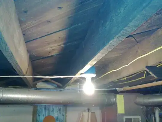

I have a basement ceiling that's around 6'6" high and currently the lights are standard bulb outlets that are attached to the beams so they sit down at eye level in the room. This means when you're walking around you tend to accidentally back up into exposed lightbulbs often.
I'd like to put some sort of recessed lighting between the beams out of the headroom. I can't seem to find a recessed lighting can that fits within a 6inch beam depth and looks appealing (most are supposed to be burred in the ceiling with trim put on after). I'd like to avoid using long florescent bulbs and stick with standard outlets or some sort of LED bulb. I will be using CFL's or LED bulbs so heat isn't going to be an issue next to the wood. enter image description here
*Updated with a picture -As you can see the current light sockets are placed below the beams. My original thought was to just move them higher up, add more, and put in smaller CFL bulbs. I'm trying to find a more aesthetic looking idea for the basement.

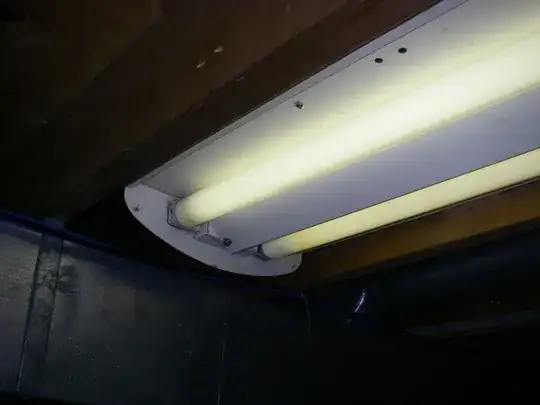

I have fluorescent tube lights in my crawlspace (talk about low headroom..). There's two fixtures each with two bulbs, which adequately light an area about 20' x 10' (and 4' high). They're mounted so they are centered between joists, and the middle of the bulb is right at the bottom of the joist (so the bulb hangs down about 1/2" below).
One of these was already there when I bought the place, it is hung using chains from hooks screwed into the subfloor above. I actually just put the other one up on the weekend, and I just cut a couple pieces of 2x4 to span between the joists, mounted them at the correct height, then just screwed the fixture to them (they're placed at both ends).

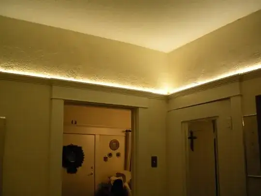

The solutions to lighting rooms with low ceilings is often to use indirect lighting around the periphery of the room. There are many types of wall lighting available. Perhaps indirect lighting bounced off light-colored walls… or maybe lighting placed along the upper-most walls pointing upward to provide diffused, ambient lighting.

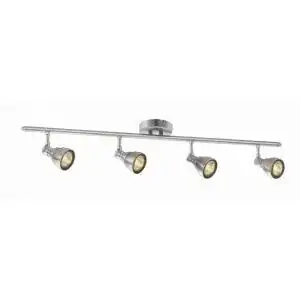

I would say pull the fixture off the beam itself and attach it in between the beams. Then you could get some track lighting that would hang down low enough to provide sufficient light, yet not drop below the beam line. Something like the picture here would work:

I have a similar situation in my basement, and one of the things that I thought of doing was to install track lighting on the side of the floor joists, close to the bottom so that the lights would be just out of the way, but still low enough that I wouldn't have heavy shadows cast from neighboring joists (I have some fluorescent strip lights mounted between joists; the contrast between the lighted area directly underneath and the shadowed area just a little to either side makes it difficult to see).

If you use track lighting, make sure you cross the beams of light instead of pointing the track to the nearest wall. This way you will get more even lighting across the whole area. It can make a big difference if you are trying to light a larger space.
