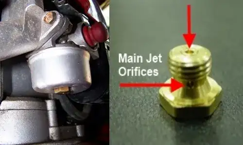

Usually, it's a quick fix, but you will get fuel on your hands. Tip the mower backwards & weight the handle down on the ground, this drains most of the fuel back into the fuel tank.
Then, you want to remove the carburetor's fuel bowl by removing just its center bolt. Clean the fuel bowl, dump it out & wipe it out. Then, ream & clean out the bolt's 2 holes with a pin or small paper clip. Reinstall the bowl & bolt & you should be solid.
Fuel Bowl And Jet
