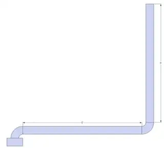

I need to run about 20 feet of duct to reach the gable, I don't want to go through the roof unless I absolutely need to, I live in Vermont and we can get a lot of snow build up on the roof, I also would prefer not to go through the eaves. Is this too long a run?

Given this duct:
There is 10' of straight smooth walled duct. Plus 2 elbows, and one terminal at the end.
EDL = 10' + (2 * 15') + (1 * 30')
EDL = 10' + 30' + 30'
EDL = 10' + 60'
EDL = 70'

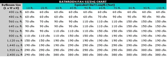

Once you've got all the information, it's time to select an appropriately sized fan. To do this, you can use a chart like this
Bathroom Fan Sizing Chart
Using this chart, you'll find that for a 640 cu. ft. bathroom and 70 ft. of duct (equivalent length), you'll need a 110 cfm fan to achive the recommended 8 air changes per hour.
