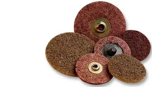

IME, Don't waste your time and money with naval jelly. BTDT, it mostly moves money from you to the manufacturer.
For a few 10's of dollars you can pick up an arbor and matching "surface conditioning discs" (essentially scotchbrite(tm) in a rotary mount) - if you have much to do, it's worthwhile to go there. If there's a huge amount, you can get belts (again, effectively scotchbrite(tm) in belt form) for a belt sander.
If the area is really small, simply getting a few hand pads of the coarse grade (brown) or medium (maroon) scotchbrite from a metalworking supplier might be enough. The green sold for most household uses is a bit wimpy/fine for this job. The conformability of the material makes it more effective than sandpaper for the most part.
Treating immediately after mechanical rust removal with a "rust conversion" primer is essential. You should also start putting money in the new roof fund - once a roof starts rusting, the clock is ticking.
