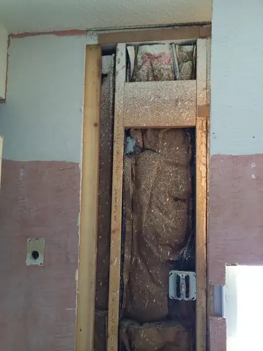

In opening up an exterior (load-bearing wall) to re-insulate it and replace wood paneling with drywall, I found a weird piece of blocking towards the top. It doesn't look like it's supporting anything, and there's nothing nailed to either side of it. I'd like to remove it, as its presence reduces the amount of insulation I can put there.

I would normally say yes but it appears the 2x4 on the right is heavily notched in a weird fashion. I would keep blocking across from this to make sure that vertical 2x4 is stable. Not really sure you need a piece that big though.
