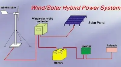

Great idea! It's actually a fairly simple setup and not all that complex. Normally you want to use multiple power sources to attempt to charge your backup battery. Here's a simple diagram that helps explain a solar/wind power system:
You can build inexpensive small turbines for the wind portion but the battery tends to be the expensive part of the setup. You'll want something that can run your devices for a while if the generators aren't making any extra power.
I've seen a setup using car batteries before which worked as a cost effective way to scale up battery power over time by just adding additional batterys to the circuit's power grid.
Keep in mind this can be a very dangerous thing to build and operate. If you're uncertain at anytime of something involving electricity/current/hot wires/etc. make sure you have an electrician present to verify it's setup correctly.
