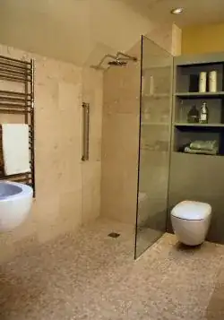

I think if you do it right, and make it look upscale, it can even be a selling feature. As you described it, I was thinking so long as there are glass walls or something, it would probably look pretty good. First search on google found a picture of exactly that:
I totally agree with boxed-dinners, if you cheap out on it or don't do it properly, it'll scare people off. If someone looks at the room and thinks "Ok, I have to remodel that bathroom" then they're not going to be willing to pay as much.
