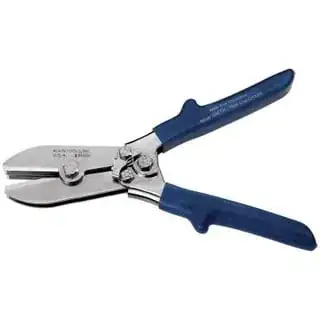

You need a duct crimper like this to reduce the diameter of the end of one piece of duct:
Run the tool around the end of the duct so that you have multiple parallel crimps. That piece should slide right into the uncrimped piece, giving you a secure connection to tape.
