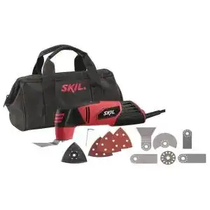

This is a great project for an oscilating multitool.
osc multitool
The front blade (and there are several to choose from) oscilates from side to side in small strokes, allowing a precise cut in both depth and width.
There are corded and cordless models availble in a wide price range. Almost all would suit for your type of project. I think you will also find many other uses for the tool, making it a pretty good DIY investment, even for a beginner.

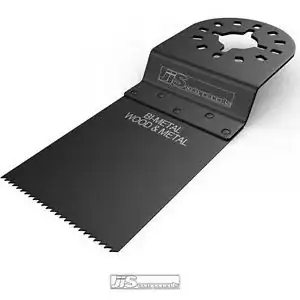

I agree that the oscillating multitool is the best tool for this situation.
In particular, one of the long narrow blades works well for cutting into a tight spot. You can plunge cut directly into the required spot, without needing hardly any side clearance. It works great.
multitool blade
I bought my multitool from a well-known cheap tool import company for about US$30, and they are even less than that when they go on sale. It would have been worth it for just one job, but I have had no problems and it has continued to work just fine. Easy to find inexpensive models by shopping on-line.
