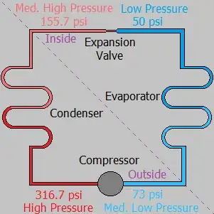

Normal System
Normal System
Temperature and pressure are the same thing in a refrigeration system, so based on the pressures shown above you can easily determine the temperature of the refrigerant . Assuming this is an R22 system, you'll see that the refrigerant enters the evaporator at 26°F, and leaves above freezing at 43°F. The suction line in this system is above freezing, so no icing will take place. The temperature may be below the dew point, so there may be sweating (condensation).

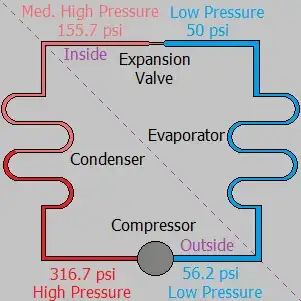

Not enough air flow
Not enough air flow
In this example you can see that the refrigerant enters the evaporator at 26°F, but it leaves the evaporator below freezing at 31°F. Since the suction line in this case is below freezing, there may be frosting/icing of the line. If the temperature of the line stays below freezing all the way back to the compressor, you'll see icing all the way along the line.
In this case, there's not enough air flowing through the evaporator. Because of this, not enough heat is being transferred to the refrigerant.
