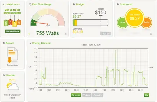

If you are willing to make a small intial investment, I would highly recommend buying an Efergy Elite / Hub.
This handy device clamps onto the mains line in your circuit breaker and measures power draw through inductance and sends it to a monitoring service over the internet for free. The device itself will run you $150 or more (if you have a 3-phase system you will usually need to buy an extra sensor because most kits only include 1-2 sensors).
Below is an actual live look at my own house:
  Screenshot
I have had the device long enough now to know that the large 9.0 kW spike at 4:30 PM is actually a combination of things - water heater, central AC and microwave. But if I did not know this, it would definitely be worth tracking down.
It is hard to be surprised by your bill at the end of the month when you can see your complete usage history from any web connected device anywhere in the world.
