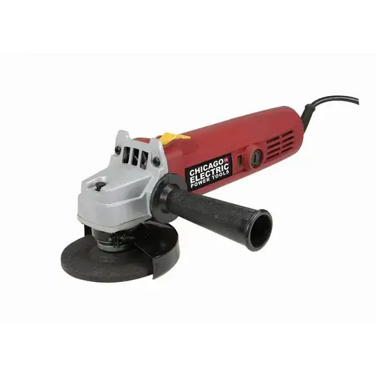

For both cutting and polishing, I used an angle grinder. In my case, I bought a 4-1/2 inch grinder like this one for very cheap from a discount tool import store (about US$20; works great).
angle grinder

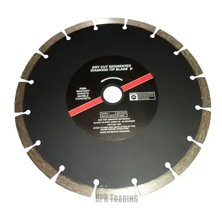

For straight cuts, I used a diamond blade (metal blade embedded with diamond chips).
diamond blade

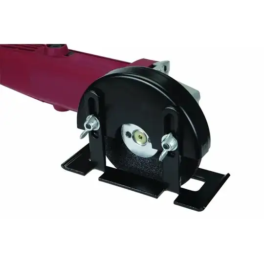

I clamped a board to the granite to use as a guide rail or fence, and ran the grinder along using a guard like this:
angle grinder guard

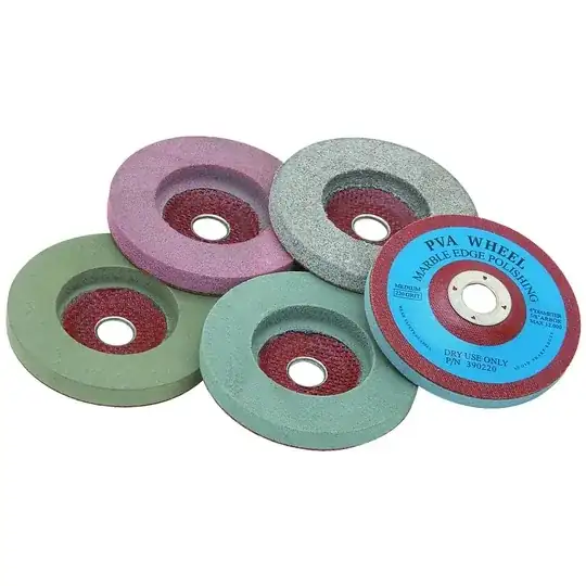

To smooth and polish the edges, I used polishing/"surface conditioning disks" designed for stone and masonry, in the angle grinder. They come in a set of various grains from coarse to fine. Just like sanding, start with the coarse and work your way up to the fine.
stone polishing disks
All of the above parts were done dry; no water involved.

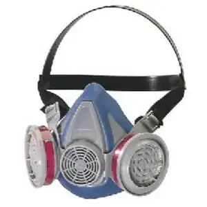

All in all, I would say it was easy and inexpensive; it just took time and created a lot of dust. Get a proper respirator face mask and don't use those little paper masks; your sinuses and lungs are worth proper protection.

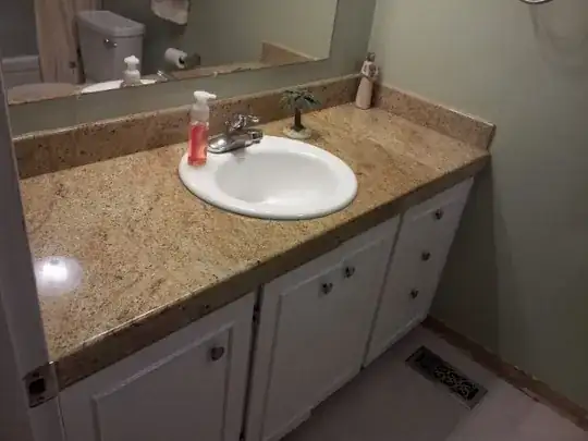

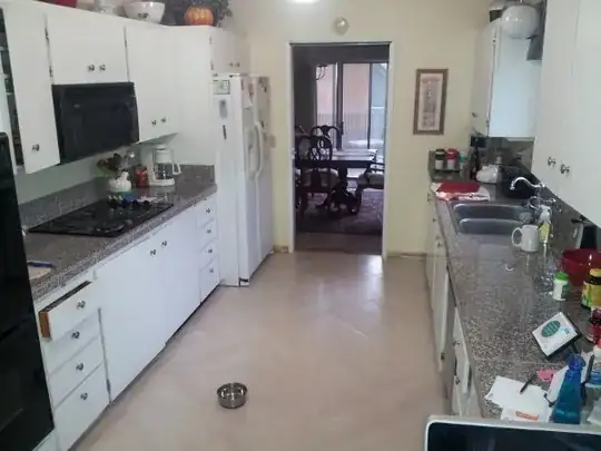

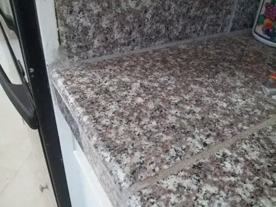

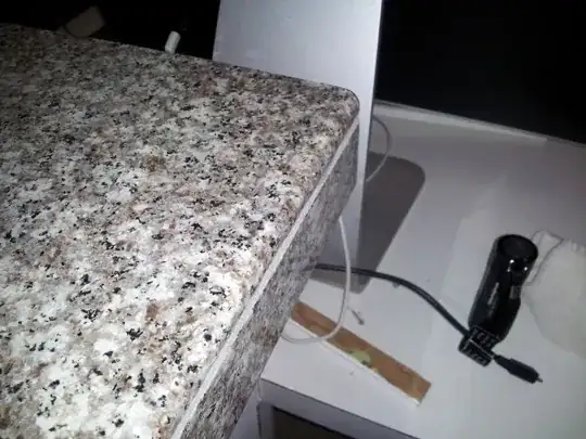

I used granite tiles for kitchen and bathroom counter tops. At the time I did the kitchen, I was only aware of square granite tiles in relatively small sizes like the 12 inch ones here. When I later did the bathroom, I discovered the larger size tiles, which were large enough to run a full tile from back to front edges. This 5 foot wide counter is only four tiles for the main surface.
Here is the kitchen with 12 inch granite tiles:
kitchen counter granite tiles
granite tiles
granite tiles
And the bathroom with 18 by 26 inch granite tiles:
granite tiles, 26 inch
