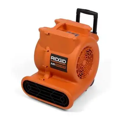

You're looking for something like this:
Air Mover
(source: homedepot.ca)
