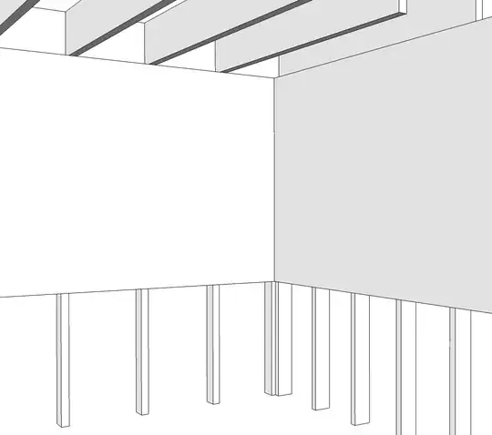

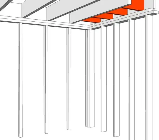

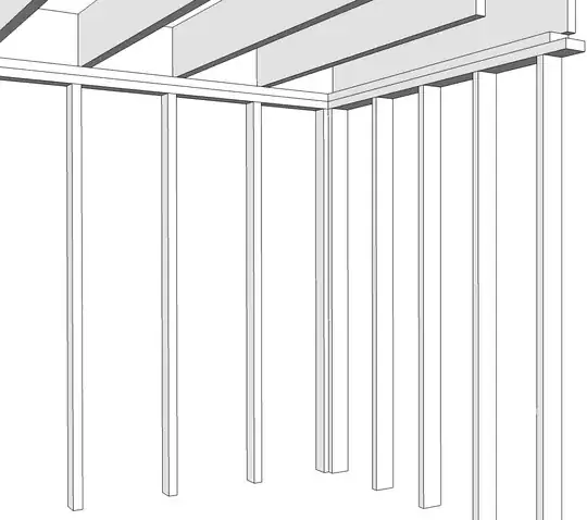

If you do the walls first, you can end up with drywall that is unsupported along an entire edge.
Taking these walls for example.
Example Wall
Walls First
If you add drywall to the walls.

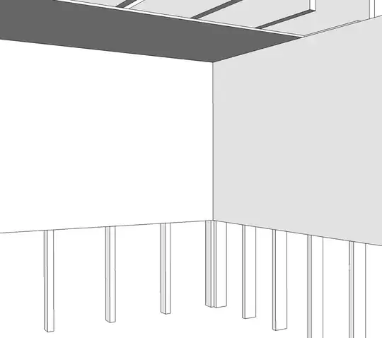

Then add drywall to the ceiling.
Drywall on Wall and Ceiling

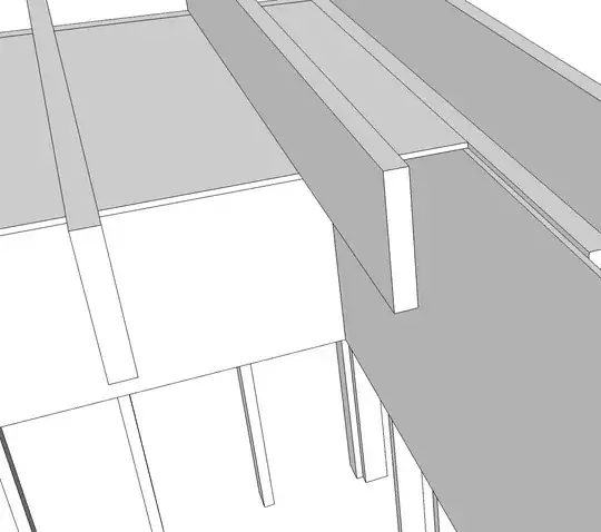

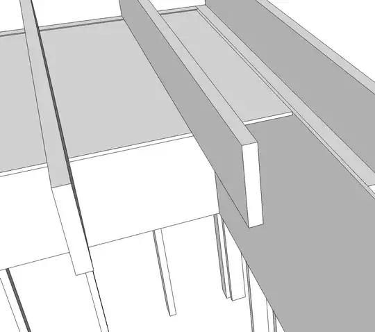

The ceiling drywall will be unsupported along the entire length of the one wall.
Unsupported Drywall

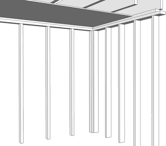

Given the same walls. If you add drywall to the ceiling.
Drywall on Ceiling

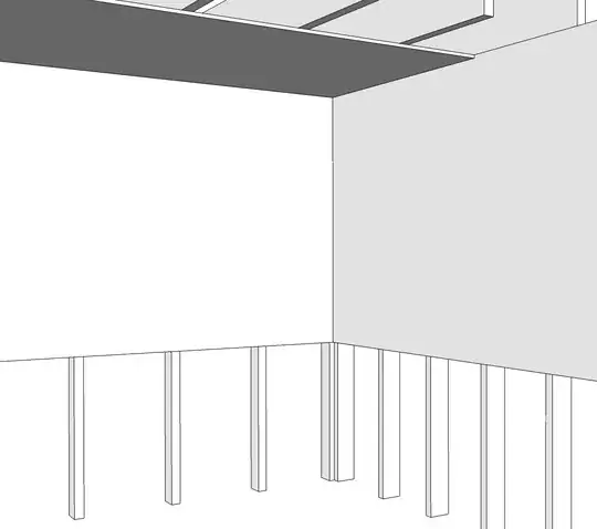

Then add drywall to the walls
Drywall on Ceiling and Walls
The ceiling drywall will be supported by the wall drywall.
Supported Drywall

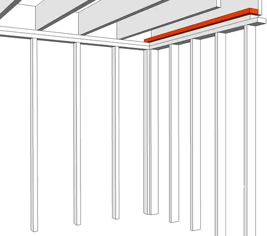

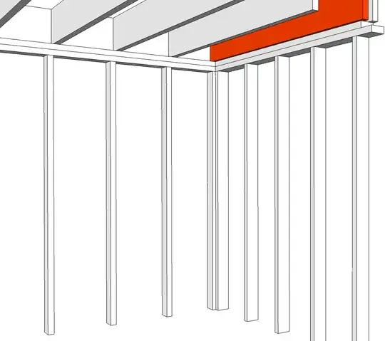

Blocking, or Extra Framing
If you add blocking; or some other framing, it shouldn't matter which you drywall first.
Blocking
Extra Joist
Backer
