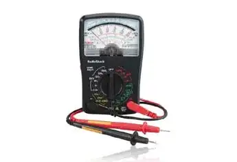

An ohmmeter is built into any cheap multimeter like this $30 model from Radio Shack and since I had one around anyway for other electrical projects this was easier than buying specialized network testing equipment.
