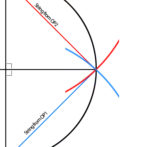

  • Then, I would use some math. Dividing the circle into quadrants would require 4 points on the outside of the circle that (of which we currently only have 2), if you were to draw lines in between all of them, would form four right triangles (with the right angle in the center, which is what you're asking for.) Knowing that each leg of each right triangle needs to be 30', the hypotenuse of each triangle must be 42' 5 (1/8)" -long (square root of 30^2 + 30^2). Armed with a string of that length, I would attach it to both of nails/stakes/marked points from above, OP1 and OP2, and I would walk to both sides of the circle, near where the other two points, which we'll call OP3 & 4, should be. Make marks where the end of this string crosses over the outside of the circle (to be exact, you should once again have the 30' center string in your hand.) See diagram below. For OP3, make this measurement from both OP1 and OP2, and for OP4, make the measurement once again from both OP1 and OP2. You should have two marks at both the OP3 and OP4 locations, and they should be so close (within 1") that you can just eyeball an average of them. Drive a nail at those locations, and draw a taut string from OP3 to OP4, making sure it passes over the center. Once again, if you're on concrete, pop a chalk line.
