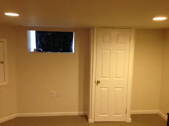

I am planning on doing built-ins on either side of the utility door in the image below:
Current area

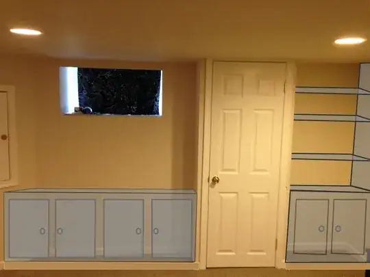

This is a crude mockup of the cabinets I'm going to build:
Mockup of Cabinets

You should cut away carpet. The cabinets will last longer than the carpet and will just be a mess when it's time to install new carpet. I'd want the cabinets secured directly to the floor, not through carpet/pad.
When you pull up the carpet and baseboard, you'll see the tack strip. If you are careful, you can re-use it, but it is cheap to replace. You'll probably want a tool called a knee kicker carpet stretcher to properly re-attach the carpet to the tack strip. You can rent them or cobble one together yourself.
Edit: It looks like you are working on a slab. In which case you'll need special tack strip with concrete nails and removing the old tack strip will be more of a chore.
In a pinch, or where the carpet is hidden from view, I have used large headed button-head screws.
