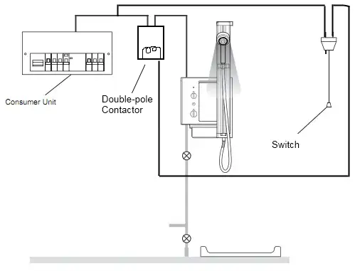

My inclination, if I were to ever install something like this here, is that 45A is too much for any type of user-facing switch that will be used on a regular basis. I would install a contactor (basically, a big relay) separate from the switch, which is rated at at least 60A (since as Nial C pointed out, depending on the exact voltage, you could be seeing as much as 52A). Then I'd run a separate circuit to the pull-switch (or whatever you're using) that simply controls the power to the contactor coil. This circuit would only have a minimal current in it (<1A) required to run the contactor coil.
Here's a quick diagram hacked together based on the Mira install manual:
Note though, I do not know if this would comply with EU plumbing/electrical codes! It seems a whole lot safer to me as it keeps a human from having to interact directly with a high current switch, and it's likely easier to replace the contactor if needed (though I'd guess it's less likely to be needed, as contactors are very commonly used in industrial systems to control high-current loads for many years without issue).
