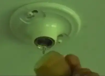

In a pinch, if you lack a bulb remover, you can use a potato to remove a broken light bulb.
Essentually, you just cut it to a size that'll fit into the socket, but engage with whatever's left of the broken bulb, then twist.
This youtube video illustrates the technique.
snapshot of the potato technique

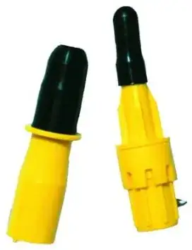

So I bought a broken bulb remover - 2 sizes of rubber tip on an insulated plastic handle. Big one slips over the little one. Broom-handle/extension-pole threads on the far end. Don't use it often, but nice to have when needed.
Bulb extractor

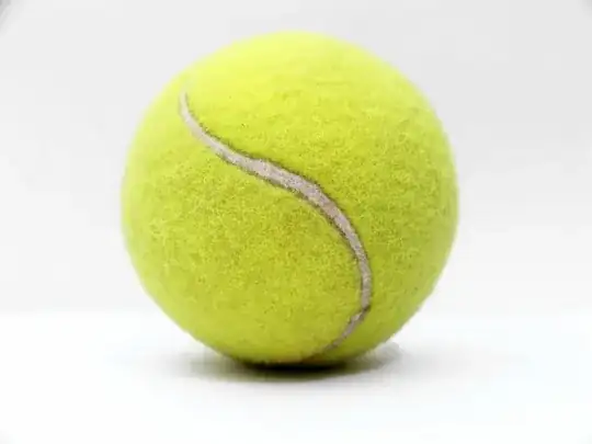

I have used a tennis ball for this very purpose. Just shove the tennis ball forcefully against the remaining bulb base, and continue pushing inward while turning counter-clockwise. Tennis ball
