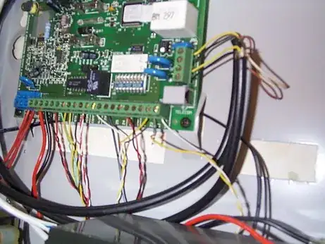

  • Disconnect the wires from the transformer, or inside the panel. They should be black and red or black and white, and marked something like "Pwr in" or "12V DC" or "24V AC". In the pic below, the power wires are the thicker wires on the left side: two go to the battery, and two go to the transformer/mains.
panel wiring

I actually found in a different forum that the reason the alarm turns on after a power failure is because the battery (that I didn't even know about) is dead. I ended up replacing the battery and it is ok now.
