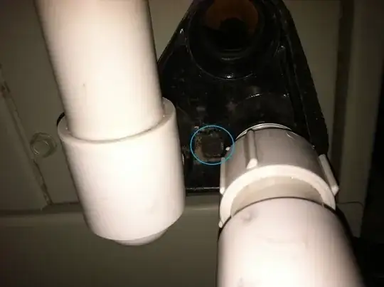

It does not look to me like it should be overflowing. It pours out of the hole circled below and then onto the floor and back into the unit and onto the filter. If it is coming out of this hole, why is it not going down the correct outlet to the pipe?!

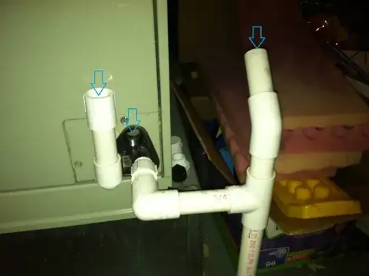

The only change point I can think of is that I purchased a box of filters on the web that had a pretty high MERV rating of 12. The fan seems to push air through the filter pretty easily, but I wonder if the new filter is somehow producing a vacuum that is not letting the water drain correctly. I removed the plugs pointed out below by the arrows to try and relieve this vacuum, but it did not make a difference. Any thought or advice?
image of air handler drain connector with drain piping showing location of removed plugs
Last night, I cracked open a cold one and just watched in the basement. I can hear the water build up in the pan as it makes a gurgling sound like some force is preventing it from draining, but it is on the verge of overflowing. Once the blower stops, all the water drains quickly. Some down the pipe, some out of the hole. If the water is building up, I simply don't understand why it won't drain down the pipe.
The water also drained when I removed the filter and left the cover off while the blower was running.

I had the exact problem with my condensate drain not draining while running. My unit design is such that the blower pulls air through the A-Coil rather than pushing it through. This design pulls air through the drain pipes and won't allow water to drain. Typical drain configuration utilizes a Tee with a stand pipe so the drain is open above the trap. This is fine if your system pushes air into the A-Coil. However the negative pressure or vacuum of my system requires that you cap off the stand pipe so that air cannot flow into the drain pan housing disrupting the gravity flow of the water. Instead, allow air to enter the drain pan through the secondary drain port. If this scenario pulls water out of the trap, consider installing a larger trap. Worked like a charm, high and dry now!
I can assume that this has been fixed by now being as that I am 2 years late, but I'll answer this anyway, that pipe on the left doesn't need to be there at all it serves no purpose (normally it is used on units that sit on their sides and have an external secondary drain pan) just put a cap on it and forget about it. The one on the right is built wrong. The vent that you see on your drain (the part sticking up that is open to the air) should be on the other side of the trap not between the trap and the unit. Easiest way to fix is just call a local HVAC tech and have him fix it we will have those parts on our trucks if not we know where to easily get them. If you don't want to go that route just go by home Depot and buy some 3/4 PVC, a male adapter, some elbows, one tee and some PVC glue. You will have to cut out all of that p-trap and rebuild it with the vent on the other side on the trap don't forget that the vent needs to end higher than the hole leaving the unit.

What you’re describing sounds like a combination of negative pressure in the compartment that the drain pan connected to and an incorrectly sized p-trap on the condensate drain.
The depth of the t-prap has to be greater than the negative pressure in inches of water column of the compartment where the drain is connected to. A t-prap with insufficient depth, will prevent the condensate from overcoming the negative pressure which prevents draining until the fan stops.

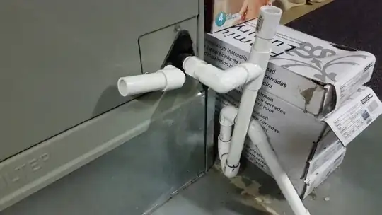

Here is my setup after correcting. I started getting overflow again and I reread the thread. I had the clean out above the trap open. I capped it with the threaded fitting and it immediately started to drain again. I'll post back if this is not a permanent solution. I made the trap one inch longer than the installation manual stated.

I read all the posts here and it became obvious that the ac was sucking air (and water) up the drain pipe, there by not allowing the water to drain down it. The problem was that I had the hose connection not fully sealed and above the p-trap. So, although I fixed the original root cause, I introduced another problem.
I ended up putting a rubber balloon over the hose connector and that solved the issue.
