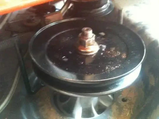

I am attempting to repair a shattered housing mandrel on my Husqvarna riding mower. I have it largely disassembled however I am facing a common problem: a stuck nut on a piece that is moving. The only leverage I can get is with the tool on the nut and the blade below. I have done some reading and seen suggestions on heating the nut but I do not have an acetylene torch handy so I'm looking for good advise. I am familiar with some of the more obvious techniques; such as whats proposed here: How to loosen a nut when bolt and nut move together?
Any advise?

  1. See the holes through the pulley face? Insert the heftiest screwdriver, steel rod, or what-have-you which fits and rest that against the biggest thing below it which does not turn. Use that to prevent the pulley from turning. Probably, you'll have to dedicate one hand to that while loosening.
  2. Look carefully at the exposed thread. The photo is not clear enough for me to be sure, but it looks like it might be reverse threaded. So to loosen, apply force clockwise (as seen looking down the bolt). Unless it turns out to be conventionally threaded, then counterclockwise loosens.

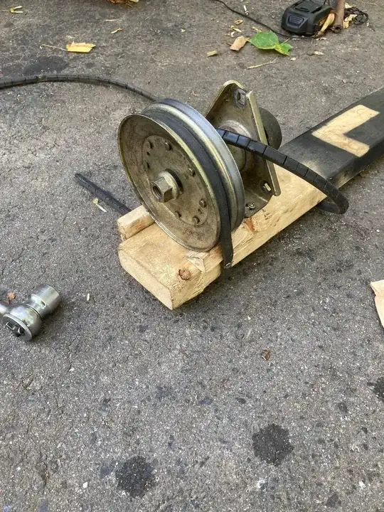

Screw an old v belt around the pully to a 2X4 or chunk of wood as tight as you can; I put wooden shims and screwed them into the inside diameter, and the belt to the shims to make it super tight so the pully wouldn't move. Then just attach the wrench and whack it as hard as you can with a mallet to knock it loose. It worked for me when nothing else would.enter image description here
