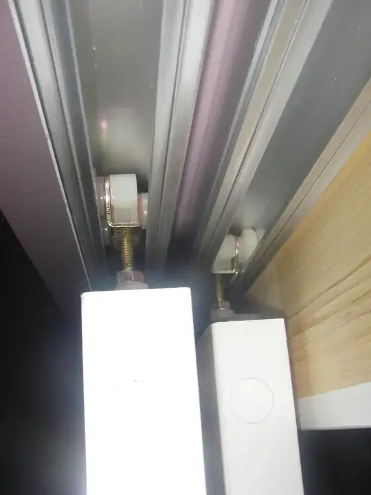

I just installed some new sliding closet doors, but unfortunately they're a bit squeaky/noisy when operating. They are "Reliabilt" doors from Lowes, the actual company that makes these is SGA. There's nothing in the instructions and nothing on their website about suggested maintenance/lubrication.

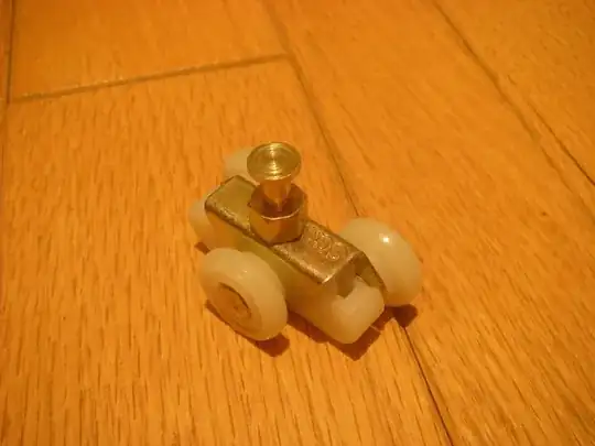

I'm not entirely sure what the rollers are made of, they're some kind of plastic or nylon rollers that fit in an extruded aluminum track.
roller mounted doors
What kind of lubricant can I use that won't break down the plastic, or gum it up over time from dust/etc?

Any dry silicon spray lube will be fine also. Do not use and petroleum based lubes or WD40. Wet type lubes attract dirt and dust and get very messy. Same advise goes for door hinges.

A PTFE (aka Teflon®) spray such as this should do the trick. They're widely available, and in several brands so you should be able to find one easily.
The squeak comes mostly from the roller turning around its axle, so I spray a little in between them and spin the roller a few times to distribute it. Clean up any excess with a paper towel. I don't have problems with them getting clogged with dust (and I think I have more than my fair share of dust!).
