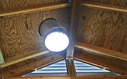

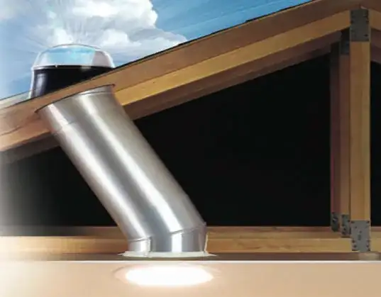

Tubular skylights, a suntube in use and available from Solatube. There's roofing and carpentry involved but no framing needed. They're the only way to have a skylight with an attic above without blowing out your ceiling. Cut 2 holes, flash it to the roof, enjoy.
