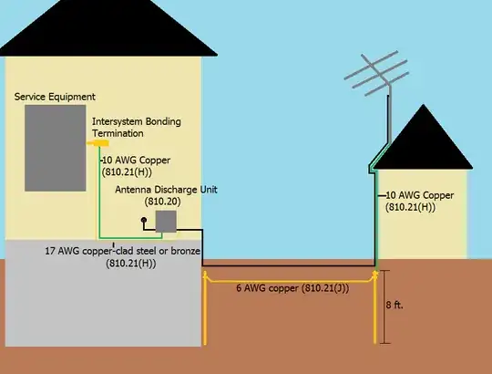

Intersystem Bonding Termination
The easiest method, is if your house has an Intersystem Bonding Termination. This is typically a terminal affixed to the outside of the service equipment enclosure, or a terminal on the outside of the house that is connected to the service equipment. In this case, you'll simply attach the ADU and cable grounding conductor to the IBT.
Grounding an Antenna IBT

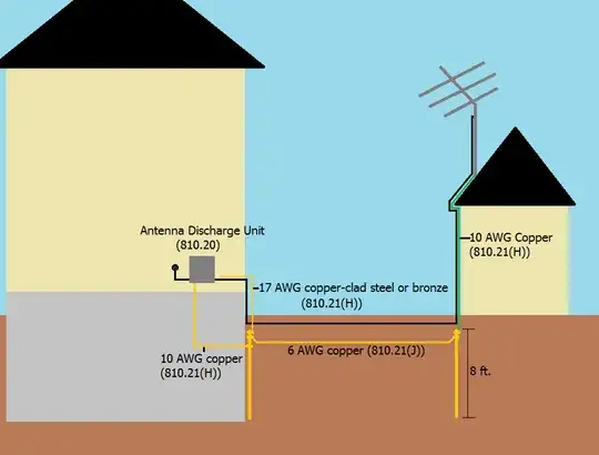

Grounding Electrode
If there is no IBT, you can connect the grounding conductors to the grounding electrode at the house.
Grounding an Antenna no IBT
